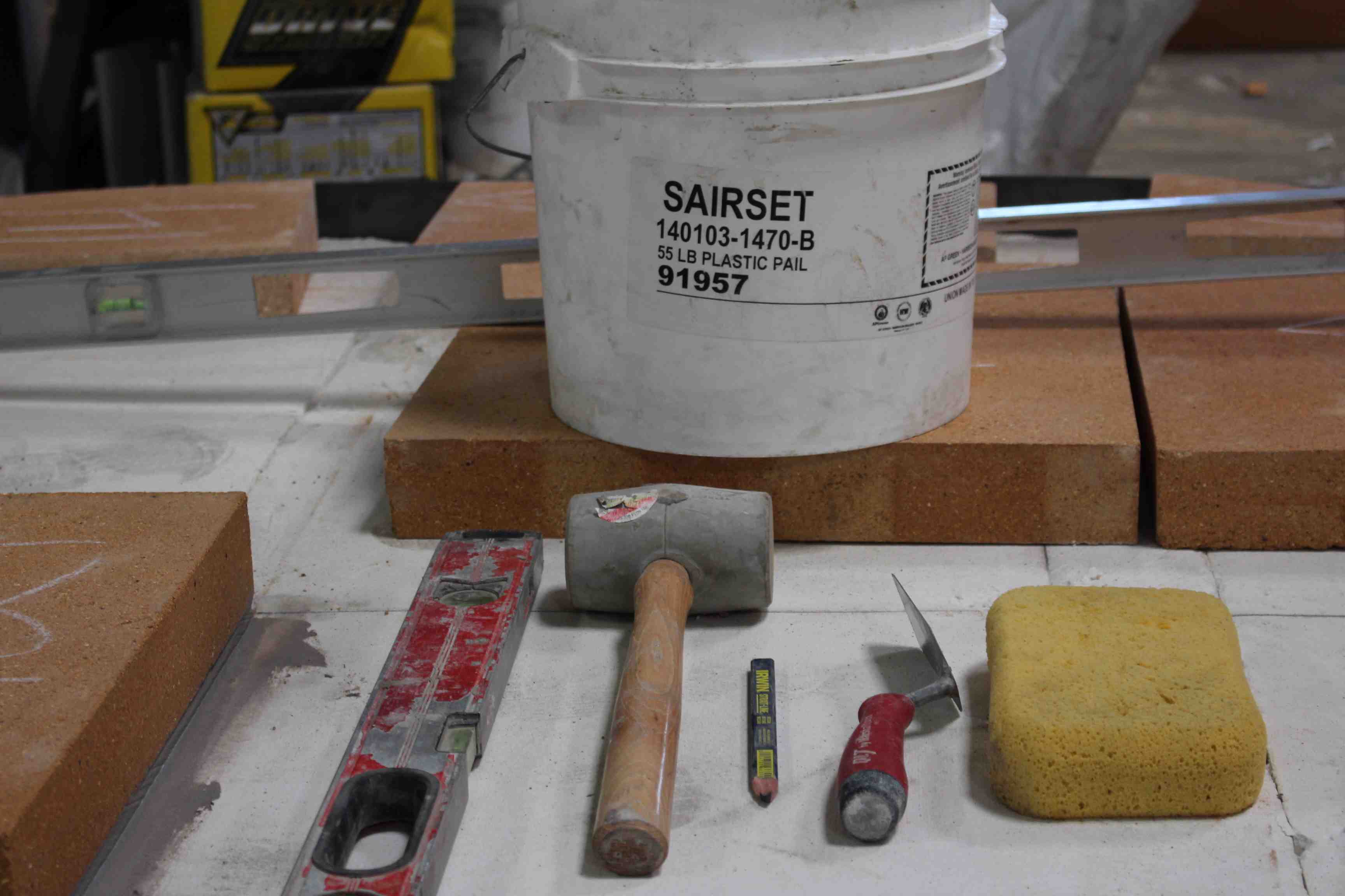

- The first picture is of of the common tools required for this process
- Carpenters Level
- Rubber Mallet
- Trowel
- Carpenters Pencil
- Sponge
- Sairset (You can substitute High temperature mortar, or 60 Mesh Sand)

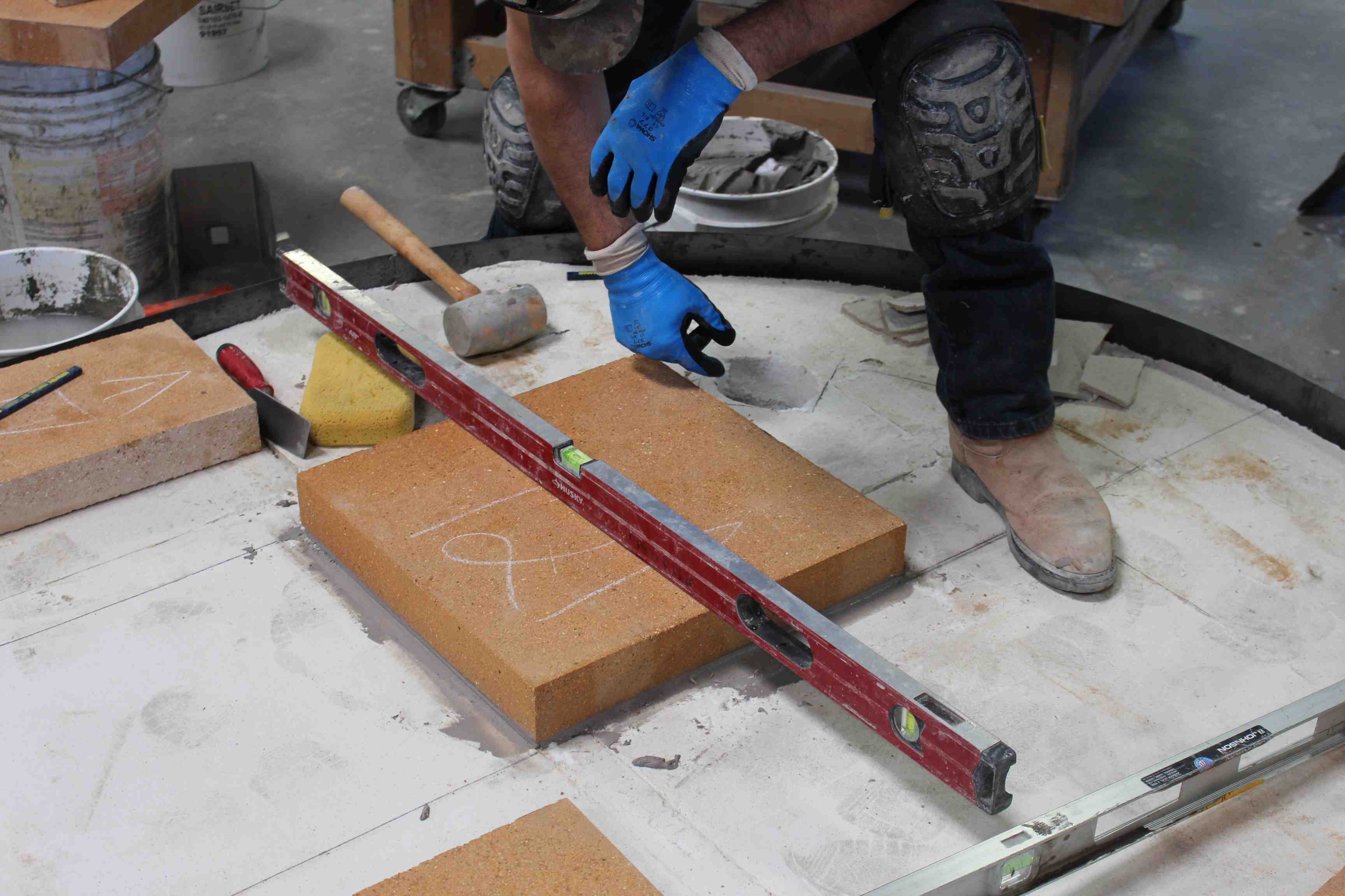

- Check the levelness of the fiber board without any tiles (not depicted).
- Layout your floor tiles starting with the highest point based on your checking the floor height with the level.
- Floor Tiles are numbered with Chalk so you know where each piece goes.

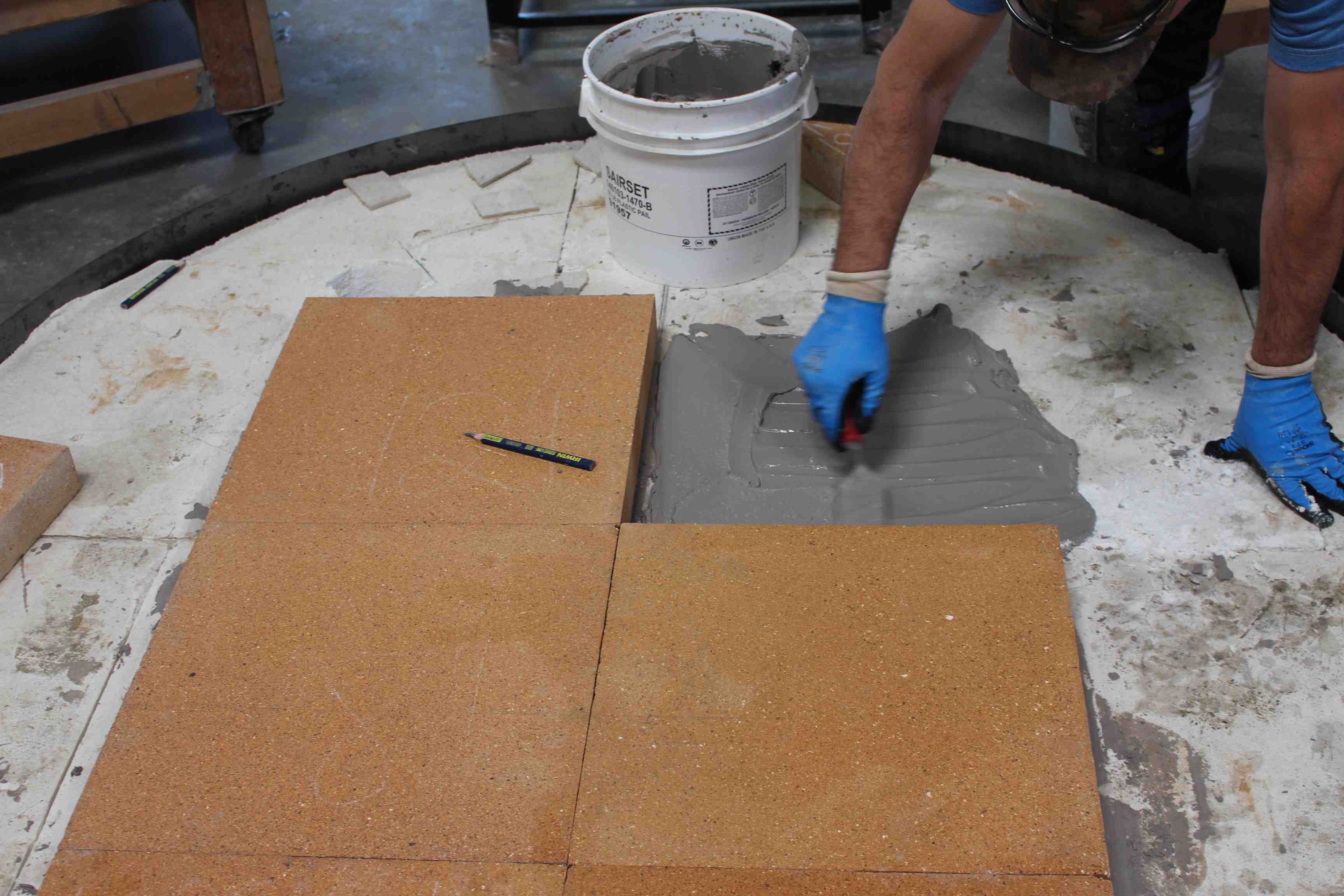

- Trace each tile onto the insulation board using a carpenter's pencil
- Remove the tile and apply Sairset starting with the highest point based on your checking the floor height with the level.
- Be careful not to go any higher than a 1/4" or you may have fit issues with your front landing and the Door.
- After each tile is placed and leveled, clean the edge of the tile with your trowel and wet sponge so the next piece will fit smoothly.
- Check with the level to ensure it is seating properly.
- You don't want the floor to have uneven surfaces or you pizza peel will catch.
- Ensure each tile pieces is pretty snug to its neighbor
- If you want to be extra careful, you can install your floor with a slight downward slope to prevent the peel from catching
